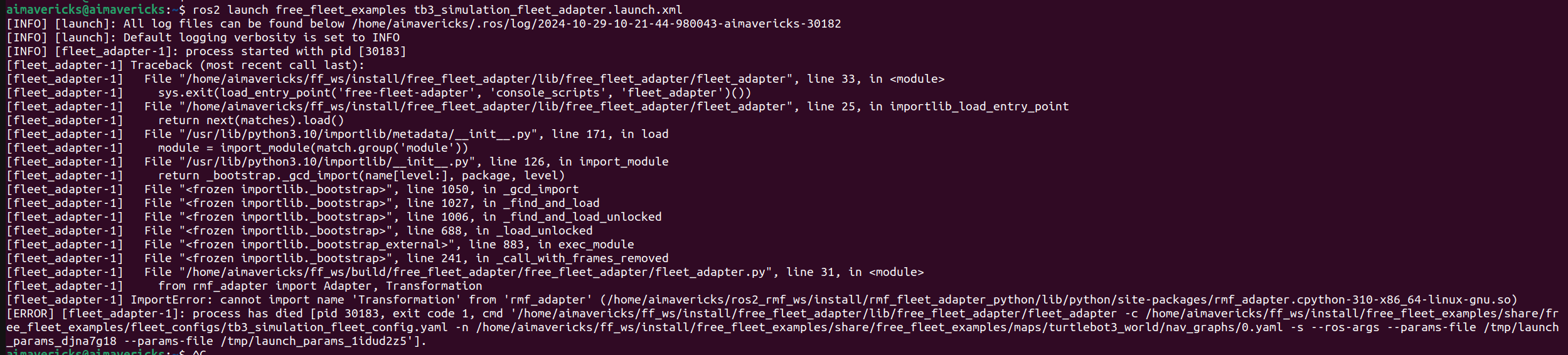

Posted by @PVijayaGanesh:
Hi I did Free fleet adapter using easy-full-control fleet adapter and zenoh bridges
Steps I follow:
Install humble rmf
clone the branch easy full controll free fleet ( git clone -b easy-full-controll <> )
zenoh v11 setup i did ..
ros2 run free_fleet_examples test_navigate_to_pose.py
–frame-id map
–namespace turtlebot3_1
-x 1.808
-y 0.503
This command is working… i sends the goal and robot is moving
when the launch free fleet adapter i got this issue..
How can i resolve this issue @luca-della-vedova @xiyuoh
