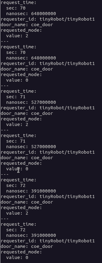

Issue summary:
when robot is at waypoint before the door and then given a task that will use the door, fleet adapter will keep publishing open and close door request simultaneously.

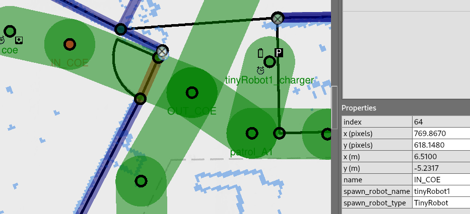

Modify office map:
  1. name waypoints before and after coe_door: IN_COE, OUT_COE`
  2. set spawn_robot_name and spawn_robot_type at IN_COE as shown
  3. remove tinyRobot1 from tinyRobot1_charger
Fleet adapter config:
finishing_request: "nothing"
responsive_wait: False
Run task:
ros2 run rmf_demos_tasks dispatch_patrol -p OUT_COE -F TinyRobot -R tinyRobot1 --use_sim_time
Result:
