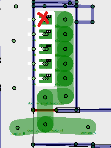

I encountered ‘Insufficient battery capacity’ error as seen below. Based on the battery system config in the fleet adapter config, it does not make sense for this error to occur.

The robot is at X.
