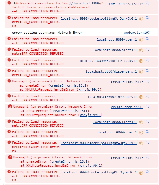

Posted by @registaz:
Hi @aaronchongth , dashboard is shown but not the maps or other data available. firewalls are all disable. I have been using a hotspot to try to get all of these working
This is what I am getting on my other device within the same network connection
Posted by @aaronchongth:
I think I have an idea where the problem lies now, check out https://github.com/open-rmf/rmf-web/tree/main/packages/dashboard#environment-variables on the environment variables needed when building the dashboard package, this points all build frontends to the server.
These are some example default values, rmf-web/packages/dashboard/.env at c885e3df14c4377273e6abbdffcfde106863c534 · open-rmf/rmf-web · GitHub, and hence when you run the frontend on your other device, it is still trying to access localhost:8000, while it should have been SERVER_MACHINE_IP:8000.
What you’ll need to do, is to set up the environment variables to be your server machine’s IP, before building the dashboard package, and serving it. After these steps, the dashboard running on the server’s machine will look for SERVER_MACHINE_IP:8000, and running additional frontends on other machines in the same network will also be working with SERVER_MACHINE_IP:8000.

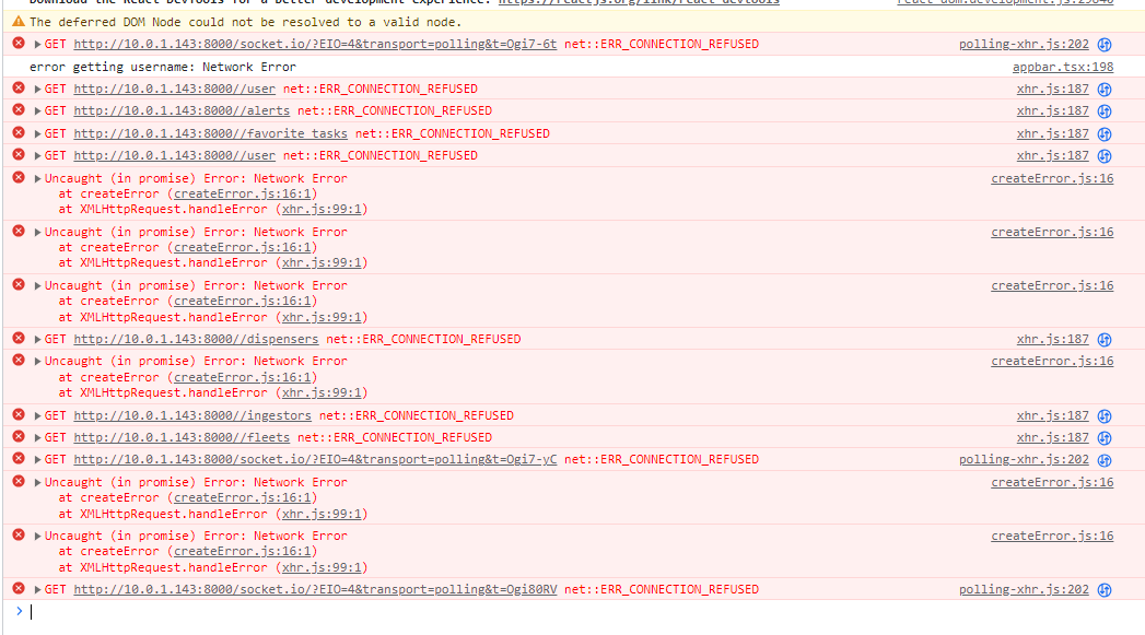

I’ve changed the address but im still getting connection refused.
REACT_APP_TRAJECTORY_SERVER targets the trajectory server of open-rmf where it uses the port 8006 by default.
Hi @aaronchongth, resolved on my side. There was another config file that uses 127.0.0.1 IP that needs to be changed.
