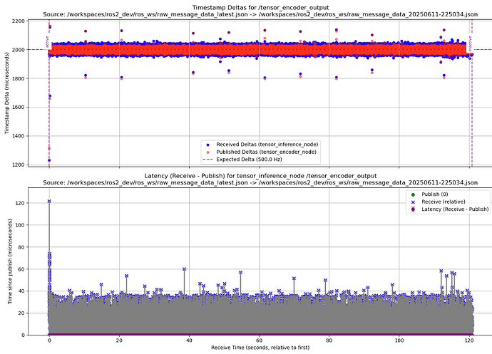

In our testing of the speed-of-light performance of ROS 2 (Rolling) for moving messages through intra-process, we’re finding some bottlenecks that may or may not be already known. In order to flush out these issues, we developed a framework to measure performance of a synthetic graph similar to ros2_performance. In ros2_framework_perf (open to better naming suggestions), we can use normal launch graphs which unlocks rclpy nodes in the graph and we can track timer-based and synchronized messages along with their histories more cleanly.
We’ll be publishing the ros2_framework_perf framework shortly to reproduce our results, but here’s what we’ve found:

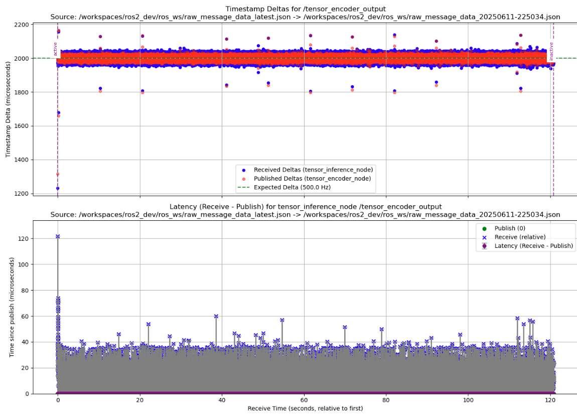

The script generates a two-part plot to analyze message timing. The top graph shows the time difference between consecutive messages, with blue dots for deltas between received messages and red dots for deltas between published messages, which helps identify the source of message jitter by comparing the stability of the two. The bottom graph displays the end-to-end latency for each message, where green dots on the x-axis mark the publish time and blue 'x’s show the receive time; the vertical distance between them represents the latency, making it easy to spot outliers and trends. As we can see in the graph above, there is almost a periodic pattern of message publishing/receiving that doesn’t hit our 500hz target. We profile the entire message passing pipeline to identity what might be the cause of these spikes in timestamp deltas, as well as the jitter around 2000 microseconds.

Ideal Case:
Ideally, we’d see all publish and receive deltas on the horizontal dotted green line in the top graph, and all blue X’s on the X axis in the bottom graph. This would indicate that every published and received message is hitting its’ desired frequency, and there is zero timestamp delta between when a given message was published, to when it was received. We believe that because our benchmark is intra-process, the jitter we’re seeing can be minimized further.

Your findings indicate that you use the events executor and not the default executor. You should mention this. It would be interesting to see the difference between the two executors.
It certainly would be interesting to see the differences, but you are correct. For the benchmarking above, we use the EventsExecutor. We created a PR here that includes these changes. Thanks for pointing this out.
