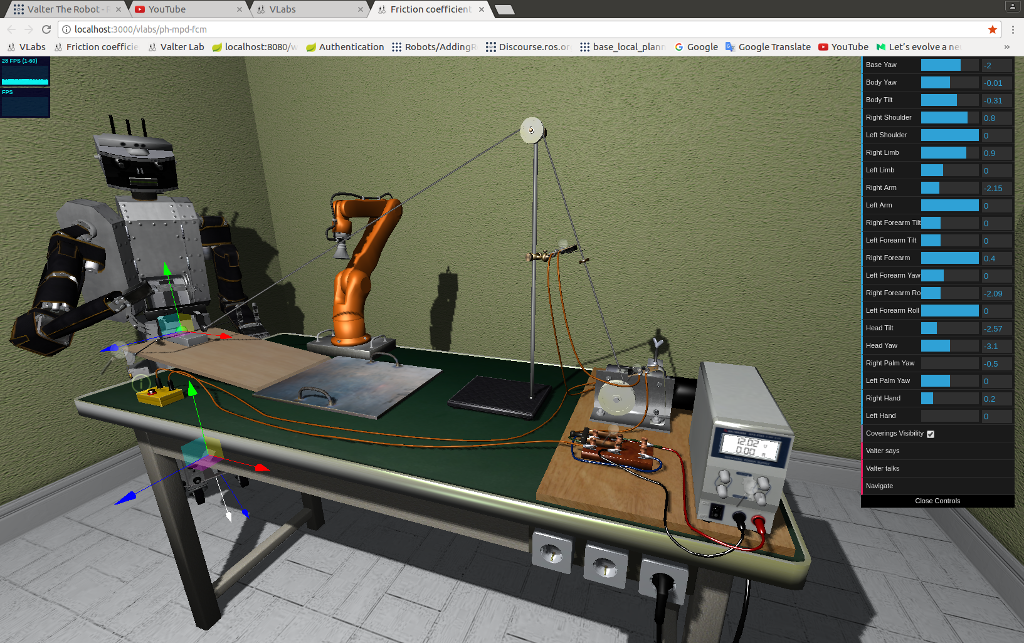

As a side project I’m working on Virtual Laboratory (web-browser WebGL based real time 3d interactive web application) for technical schools/universities where I used highly detailed textured Valter model.
https://www.youtube.com/watch?v=EM_nQ7yRie4
In future plans I have an idea of integration Virtual Laboratory with real Valter.
