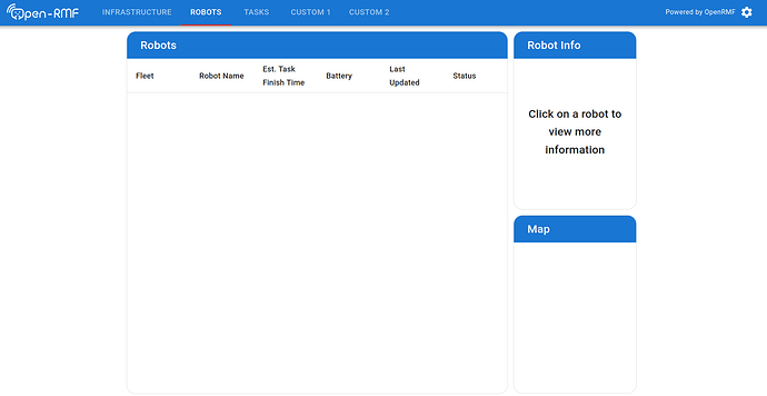

I am using the slotcar plugin and for some reason, the battery percentage is not shown, although I’m publishing the battery state. In robots that don use the slotcar, it works perfectly, but for some reason the slotcar doesn’t allow this to appear in the webpage.
Any ideas of why this could be happening? How does the information of the battery state reach the webpage? What are the nodes involved an the communication channels used?
Thanks
Posted by @Yadunund:
The battery % comes from the battery_percent field for each robot in the FleetState msg for a given fleet. If you’re running a full control fleet adapter with a registered FleetUpdateHandle, it will take care of publishing the battery % if your adapter calls update_battery_soc().
When you say you’re using the slotcar plugin, which fleet adapter are you using to control the robots in simulation? Is it the rmf_demos_fleet_adapter?
Also, from the screenshot above, it looks like you’re using the deprecated rmf-panel. We strongly recommend switching to rmf-web which is better maintained and has a lot more features.

Well I didnt get the slotcar to at least make in the webpage appear the battery percentages, if that’s question.
I don’t quite understand how the battery status info gets to the webpage through the slotcar. Using the free fleet system, it shows but with simulated only slotcar simulations, it just appears that check box, no percentages
Posted by @aaronchongth:
The battery percentage is calculated in slotcar, rmf_simulation/rmf_robot_sim_common/src/slotcar_common.cpp at main · open-rmf/rmf_simulation · GitHub, and published as a RobotState which the demo fleet manager keeps track of, rmf_demos/rmf_demos_fleet_adapter/rmf_demos_fleet_adapter/fleet_manager.py at main · open-rmf/rmf_demos · GitHub.
the fleet adapter sends a request to get to obtain this battery rmf_demos/rmf_demos_fleet_adapter/rmf_demos_fleet_adapter/RobotClientAPI.py at main · open-rmf/rmf_demos · GitHub, and this gets populated into the robot state API, which the rmf-web dashboard uses.
The rmf_demos panel is not actively being maintained at the moment, the web dashboard should be the way to go to work with the demos.
