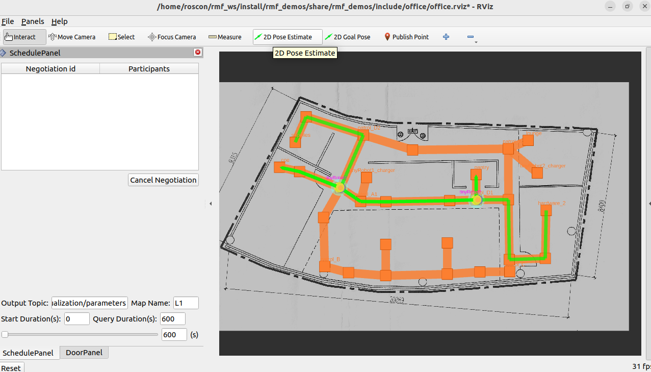

  3. i cannot get the RVIZ to work is there a building system to build RVIZ from the traffic editor. *hence it is currently commented out

Sorry, let me clarify, how do i mesh the map i used in traffic editor with the nav-graph route such like the rmf- visualisation example taken from: GitHub - open-rmf/rmf_visualization: Visualization tools for OpenRMF
currently rviz only display a blank screen with negotiation table. pretty much similar as to running ros2 launch rmf_visualization visualization.launch.xml as a standalone.
The building map will need to be served by the building map server like this, rmf_demos/rmf_demos/launch/common.launch.xml at main · open-rmf/rmf_demos · GitHub, in a demo.
Don’t forget to change the map/level name in rviz’s schedule panel.
Could you explain a little more what you intend to do with rviz? You should be able to install rviz though sudo apt install ros-DISTRO-rviz2.
additionally, i also cannot make the negotiation to appear when the rmf-task is publish in the any demo or the roscon-workshop vbox even though, the tiny robot is clearly moving.

there seems to also an issue of the initial_map_name to L1 however it may be correlated or not.
Please do correct me if i am wrong, since the rmf-task is recognizing the map i thought this may not the main issue as to the inner workings of Open-RMF.

Second the ROSCON-WORKSHOP issue:
You mentioned that the issue was present in GitHub - open-rmf/roscon_workshop: Materials for Open-RMF workshop at ROSCon 2022 Kyoto as well? Do you mean the default world in the workshop, or the modifications that you’ve made were not working?
the issue is that the schedule panel is not displaying the traffic schedule.
from the vbox: https://drive.google.com/file/d/1_a6q_9ggtrBtlA7Fghw5iYWkVrWlapDV/view?pli=1
i execute ros2 launch demos: ros2 launch rmf_demos_gz_classic office.launch.xml
and
cd ~/rmf-web/packages/dashboard
pnpm start
  1. the GAZEBO and RVIZ2 is displaying as intended.
  2. rmf-web also displays the map and the door panel as its supposed to be.
the issue is that the RVIZ2 schedule panel did no respose once i execute the task:
such like this:
However, as the picture above,the negotiation ID and the task did not appear in the rmf-web and the RVIZ2.
is it supposed to display the negotiation id for the traffic system of Open-RMF or is there a visualisation method to see the changes in open-rmf traffic.
Hmm unfortunately I am not sure what you mean by this. Do you mean nothing happened? But from the rviz2 screenshot you provided, it looks like the trajectories are present and it is responding accordingly.
The negotiation panel is mainly used for debugging purposes and might not be actively maintained at the moment. There is also a chance that there are negotiations happening at the moment, hence no IDs are shown. Negotiations are present only when the trajectories seen in rviz2 is red in color, in your screenshot they are green, hence no negotiation is happening.
As for rmf-web, try refreshing the task queue table, there is a button.
Only recently we’ve merged auto refreshing the task table, Feature/task table auto update by aaronchongth · Pull Request #763 · open-rmf/rmf-web · GitHub.
