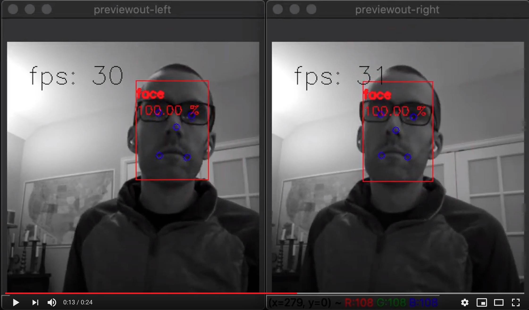

And here’s a similar version but for finding 3D location of facial landmarks in real-time (running the face detector -> facial landmark detector in series, and those together in parallel off of the global-shutter/synched stereo pair):
Spatial AI

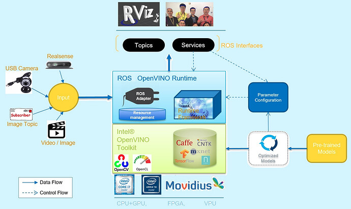

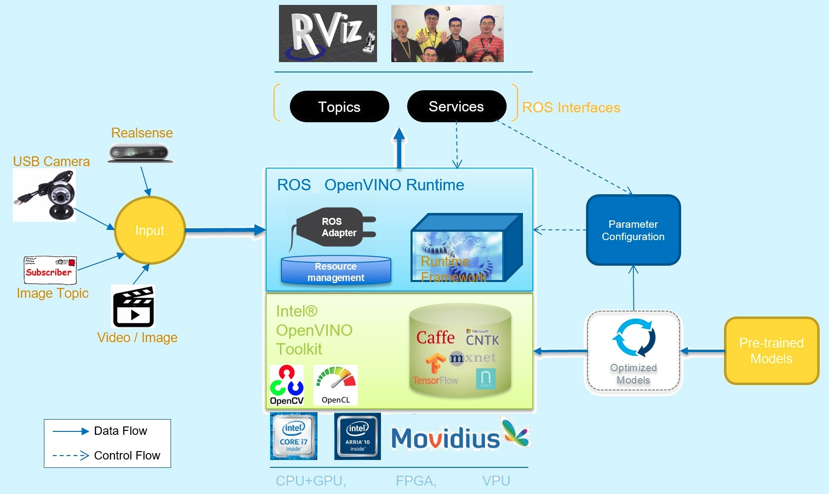

FWIW, we are OpenVINO compatible (see Intel’s official ROS-OpenVINO here), but unlike I think all other OpenVINO-compatible devices DepthAI does not need a host to run (it can run neural models standalone) and so the modality below of using the ROS adapter is perhaps not ideal considering DepthAI can be a standalone PoE device (as above, if it could show up as a ROS 2 node when plugged in that would be way easier/better UX).
Thoughts?
