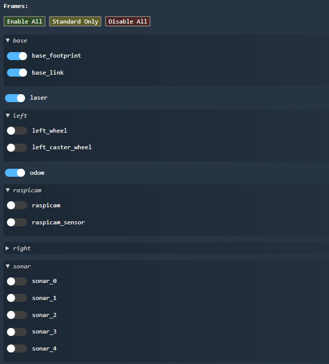

TF frames now get grouped together by prefix, for clarity:
