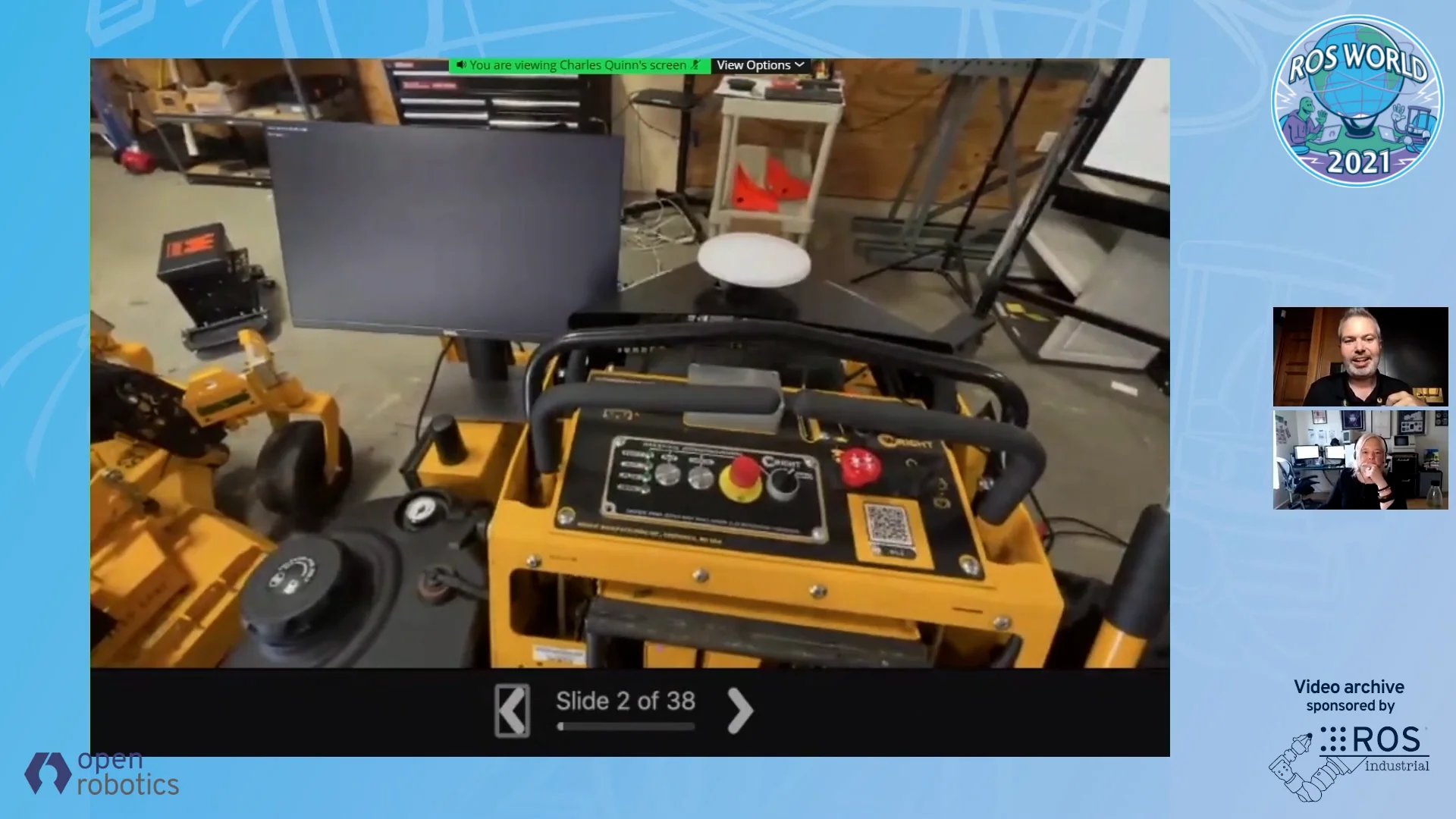

I gave a ROS talk on our apt update and quick booting kernel and minified OS at the last ROSCON.
Weā€™ve since as @agummybear mentioned in a previous thread changed it to download packages, and then install on boot.
Iā€™m sure weā€™ll see some more errors in the field, but we push out package updates every few weeks and (knocks on wood), have not bricked any yet.

@SeeBQ I have seen your video before! I think it may have even planted the seed that set me on researching this topic fruther! :smile:
Why did you consider going down this path opposed to using dual copy, containers or a combination ?
As @AGummyBear also indicated in their post, how do you envision updating to ROS 2 and different OS versions for the devices that you have in the field?
Also by making a somewhat custom quick booting kernel and minified OS are you not afraid of lacking the security updates and other goodies that are being pushed online by Canonical/Ubuntu ?
