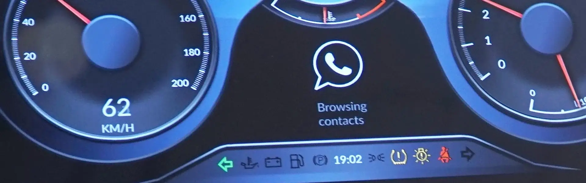

I guess it depends on your use case, but I don’t have any issues with Qt productivity wise, and it seems like a good option (not sure what your particular issues with it are). It also just got an ISO 26262 option for those industrial users who need that sort of thing and are willing to pay for it:
