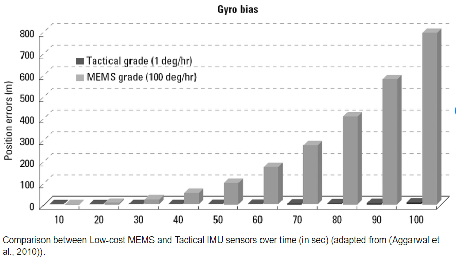

According to different scenarios, IMU has different requirements for accuracy. High accuracy also means high cost.
Low-precision IMU: used in ordinary consumer electronic products. This low-precision IMU is very cheap and is commonly used in mobile phones and sports watches. It is often used to record the number of steps.
Medium-precision IMU: used in unmanned driving. The price ranges from a few hundred to tens of thousands of yuan, depending on the positioning accuracy requirements of the unmanned vehicle.
High-precision IMU: used in missiles or space shuttles. Take missiles as an example. From the launch of the missile to the hitting of the target, the aerospace-grade IMU can achieve extremely high-precision calculations, and the error can even be less than one meter.
In addition to the accuracy and cost, IMU has two very critical characteristics. The first is the high update frequency, and the operating frequency can reach more than 100Hz; the second is the high calculation accuracy in a short period of time, without too much error.
