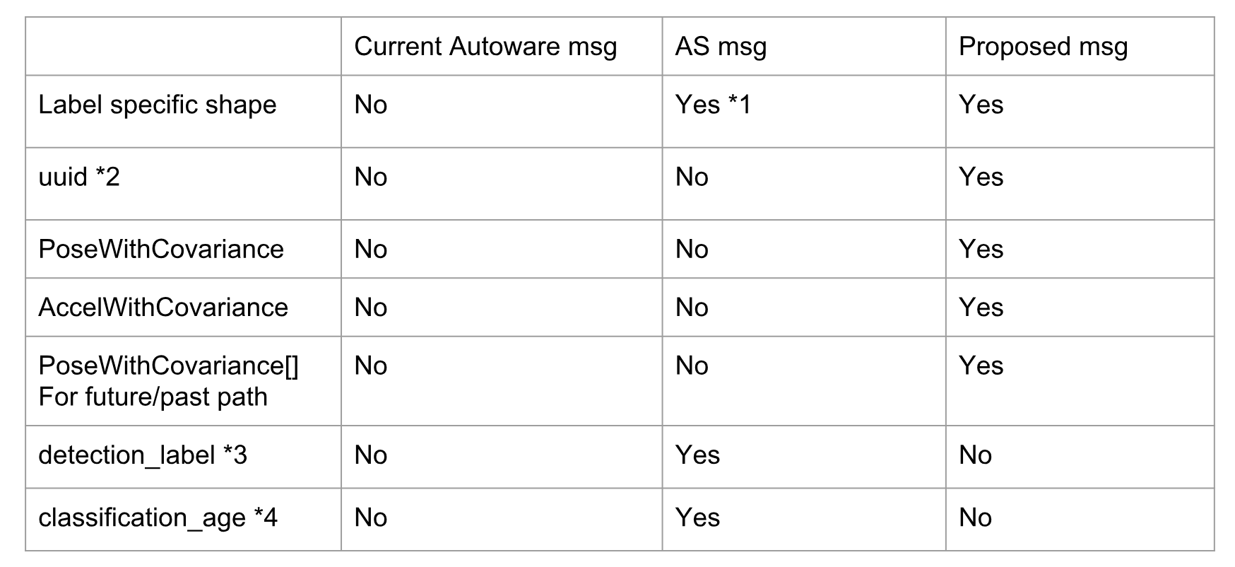

About derived_object_msgs
derived_object_msgs is made with the same idea as the current message type as @JWhitleyWork said.
Perception%20architecture%20(Not%20including%20localization)%20(2)
@yukkysaito Can you give a detailed comparison of what each of the three message types can store?

@Kosuke_MURAKAMI - Please see http://docs.ros.org/melodic/api/derived_object_msgs/html/msg/ObjectWithCovariance.html for a version which contains the PoseWithCovariance, TwistWithCovariance, and AccelWithCovariance. The uuid is definitely a useful addition that we had not considered and would be happy to add. This was the intent of the “id” field but it is somewhat limited as an int.
thank you @Kosuke_MURAKAMI.
As a side note, I think that the label specific shape of AS msg is No. It can not switch between polygon and SolidPrimitive. It can switch only in SolidPrimitive (Cone, sphere, bounding box, cylinder). This is also important from the point of view of multi object tracking and path planning.
@JWhitleyWork
Who uses detection label and classification age for what?
If we add items widely, when we modularize detection, tracking, and prediction, these modules will have to fill in these items. Some algorithms may not be filled. I think that it is better to define only what is really necessary in msg.
@yukkysaito - I think the field you’re referencing is “detection_level” which is meant to indicate whether this object has been “detected” or “tracked.” From the notes in http://docs.ros.org/api/derived_object_msgs/html/msg/ObjectWithCovariance.html, here are the definitions:
A Detected object is one which has been seen in at least one scan/frame of a sensor.
A Tracked object is one which has been correlated over multiple scans/frames of a sensor.
An object which is detected can only be assumed to have valid pose and shape properties.
An object which is tracked should also be assumed to have valid twist and accel properties.
The validity of the individual components of each object property are defined by the property's covariance matrix.
classification_age indicates the number of “scans” or “detections” made of the object where the classification type is the same. When a sensor classifies an object, it usually tells you how many “scans” of that object have been sent since the object was classified as that type. This helps determine the certainty of the classification.

I listed the differences between derived_object_msgs/ObjectWithCovariance and DynamicObject, and heard why DynamicObject is constructed in such a way. I’d like to clarify the differences and reasons, and like to make more common view in the whole community.
@JWhitleyWork Would you comment about the different information?
Same information
  • geometry_msgs/PoseWithCovariance pose
  • geometry_msgs/TwistWithCovariance twist
  • geometry_msgs/AccelWithCovariance accel
  • geometry_msgs/Polygon polygon and geometry_msgs/Polygon Shape::footprint
New common view
Different information
Note
PoseWithCovariance[] past_paths is removed from DynamicObject since planning is not interested in past information. Though prediction will require past information, it can be resolved inside prediction.
Thank you for the summary. Do you have any opinions?
I think the reasons of DynamicObject are reasonable since I created the table based on the hearing :wink: My opinion is already reflected into the table, e.g. object_classified and past_paths are not necessary.
@JWhitleyWork Sorry to bother you again. Would you comment about the different information? I’m not familiar with the background of ObjectWithCovariance.
@kfunaoka I’m sorry it has taken so long to get back to you. Here are responses addressing your issues:
The object does have a header field. However, it does not need to be populated and ObjectWithCovarianceArray also has a header.
The types listed for “classification” are not exhaustive nor definitive. As far as I know, the message type has not been extensively used so it is open to modification. We have only done tests with it internally and have not released any packages that use it. I agree with your assessments for the “UNKNOWN_” types. They were types provided by a sensor vendor so we included them.
Not a problem to change the classification_certainty to a float (0-1).
Many algorithms use a convex hull bounding area to define an object. This is why “shape” was included. There is also geometry_msgs/Polygon polygon in the message for defining a non-normal polygons.
Regarding the rest of the comments: I think the overall concept is that our message structure for these is flexible. We can add or modify just about anything in the message, though I would prefer not to remove much (if any) of the fields.
