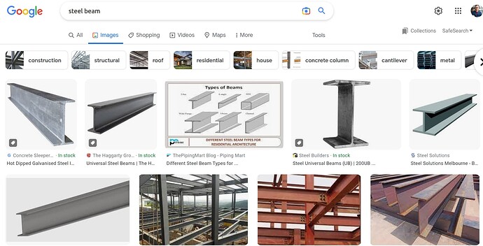

I googled a bit and I’m going to assume you want to climb a steel beam that looks like this:

How to accomplish beam alignment of the robot? I can detect the beam but are there ways of teaching a robot its orientation to a 2D image, maybe detect the beam and give it a coordinate system?
I assume you are using a RGB camera, some kind of normal usb cam/mipi cam plugged into a Nvidia Jetson, which is all carried on top of your robot. I’m imagining something like this random robot I found:
If you calibrate your camera (you can use the ROS camera calibrator, it’s pretty easy, and if you have never done it before, you’ll learn how basically every camera intrinsics calibration works conceptually) you will be able to determine your focal length (f) in between other parameters like the image center coordinates (or you may already have this from the datasheet of the camera).
If you have a bounding box of your metal beam (I suppose that is the output of your detector), you can calculate the center of the bounding box (Bx, By), then calculate the difference between the center of the image (Cx, Cy) and the bounding box center (Dx, Dy). With that you can calculate the angle from the camera to the steel beam:
angle_x = atan(Dx / f)
angle_y = atan(Dy / f)
If that is enough for you to drive your robot towards the steel beam, well, great!
You could go step further if your detector also tells you the angle of the steel beam. I imagine that the robot is on the floor, trying to go towards the steel beam (which is a beam that is “perfectly” vertical standing on the floor), to then start climbing it, so you want to have the robot looking perpendicular to the steel beam. So if the detector can tell you that you are looking at a beam at… 90 degrees, you know you want to approach it so you end up facing the flat face.
You could estimate how far the steel beam is without using other sensors. I imagine you could put the robot in front of the steel beam at a known angle and distance, say, 2 meters, and then measure, in pixels, how wide the beam is in pixels. Then, you can use that measure in pixels to extrapolate how far the beam is.
However, I may be overthinking here!
