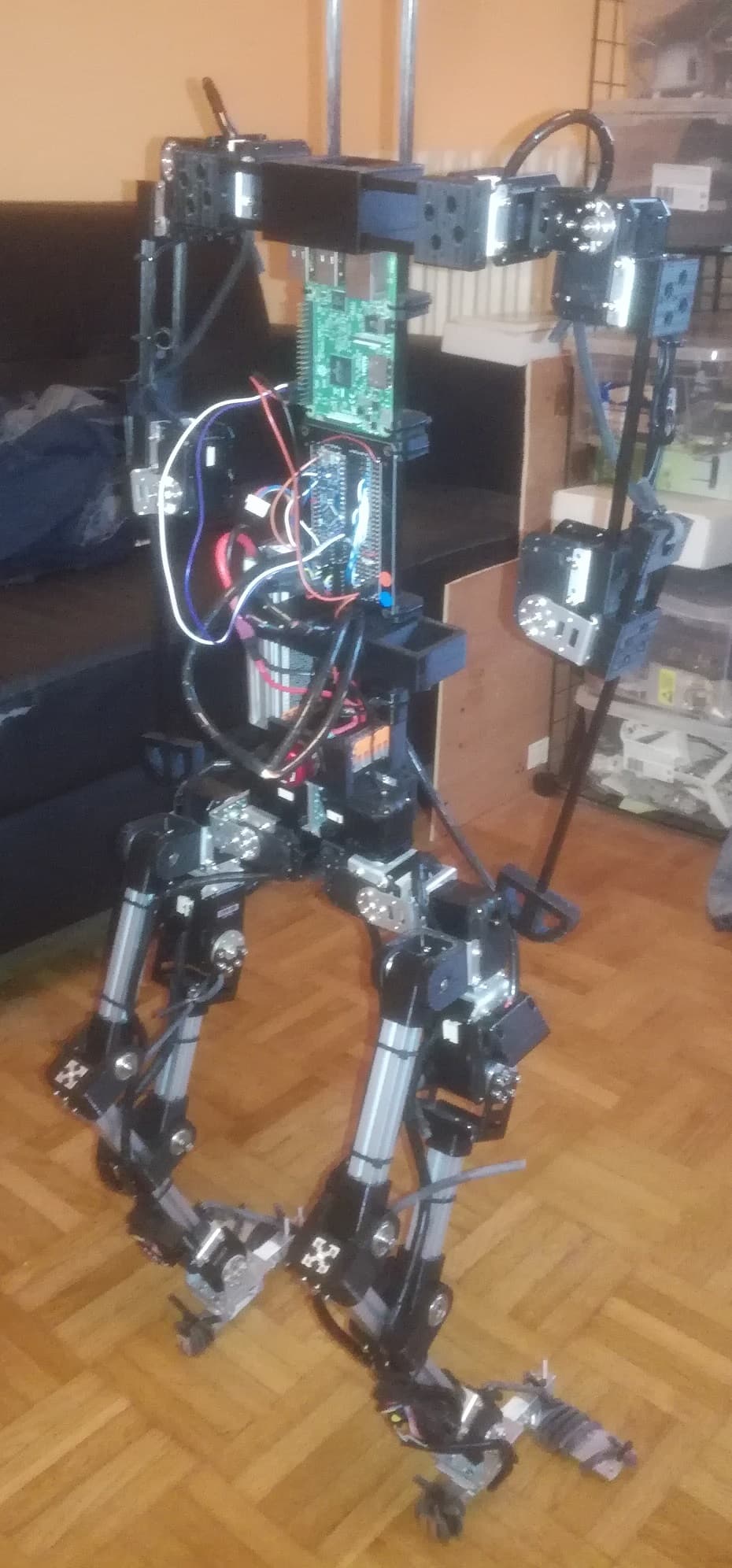

The project I present here is the continuity of a personnal project I started 14 years ago about making a dynamic walking robot in the passive philosophy and open source.
Until now, the software for these robots where based on python 2.7 scripts with a unique control loop.
I use ROS1 professionnaly already as roboticist.
The new project I start uses ROS2 on a RPi3 with Ubuntu server installed. The motors are Dynamixel piloted by USB2AX dongle. The sensors are managed by an Arduino Nano Every connected to RPi via UART.
Here are the links for the different parts of the project still in evolution :
The Arduino Firmware repository is here : Arduino Firmware
The ROS2 source repository is here : Lapin lab sources
The NodeJS source repository for web control : Web control sources
The playlist with experiments : Youtube playlist
The philosophy is to study an easy way to pilot dynamic and low cost biped robots. I know this is a big challenge but it is very exciting even if I never succed. I did understand a lot of things thanks to this long term project.
I started my study on this subject in the Delft Biorobotic Laboratory that is why I want to understand walking and make it mechanical and soft at the same time.
The structure of the ROS2 code
lapin_driver
All the drivers of the sensors are gathered on an external Arduino Nano with a specific firmware. The sensors are
  • an IMU (MPU6050) for which I use the DMP hardware to compute pitch and roll angles. It is placed on the upper body. The roll and pitch rates are computed a posteriori so that there are consistent with the angle measurement.
  • two resistive force sensors on each foot (front and back) read by a HX711 analogic reader
  • A start button to make a race
All the motors are Dynamixel, with a USB2AX dongle and the Python Pypot library. The driver has the inverse kinematic of the parallel mechanism
The control of the robot is made by a web based interface connected to zeromq protocol to send and receive very simple messages. This is done by a zmq driver which agreggate all the states of the robot.
lapin_control
This node makes the link between the others nodes, security and web control. The controller is based on a finite state machine. This is the part to be improved.
lapin_msgs
Custom messages to support ROS2 communication
The first tests of walking were done in a single Python 2.7 script without any way to save data bags to analyse the dynamics and with difficulty to modify tunings. This is why I decided to switch to ROS2.
I did the install of ROS2 Foxy (base) on Ubuntu-Server 20.04 on a Raspberry Pi 3b.
The install is done quite easily (except for the headless wifi which is not well documented)
The robot is connected to my laptop Ubuntu 20.04 with ROS desktop. The topics are communicating between the two hardwares.
I did follow the tutorials to create my first ROS2 nodes.
I also installed NodeJs12 for the web interface
The first start led to spurious crashes of the RPi (unable to connect via SSH). The thanks to the work on turtlebot3 there were this issue resolution
I first started with a sampling time for each nodes at 20ms but the Raspberry Pi hangs after 2-3minutes.
HERE IS WHERE I AM.
I wanted to publish my project here to share the project, the issues and happy moments of robotics :slight_smile:
And also to get help if possible.

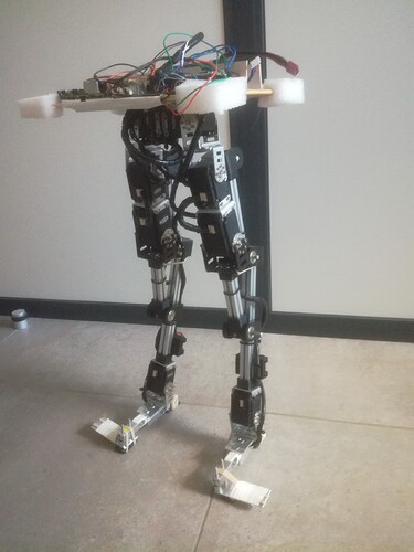

Thanks to a friend, I have new mecha. Soon the BOM !
Here is the partial BOM for the robot, I still have to draw electronic schematics.
This is awesome, why didn’t you upgrade to the newer version of python still?
Thank you. I am translating all to Python 3. I was using it since some of the library were not tested in Python 3 yet.
I am switching to ROS2 little by little but there are others big issues since the binaries on Raspberry Pi Debian distribution are not available. The Raspberry Pi 3B+ as not enough power to compile ROS2-core while the Ubuntu distribution on Raspberry Pi is not the official one (and the main features and performance optimizations are then not accessible)
Raspberry Pi 3 with ROS2 Foxy is a big puzzle when you are not fluent in all the ROS2 vocabulary.
I think about retrograding on ROS1 with Neotic.
Here is a mechanical update of the robot which can be converted in quad
