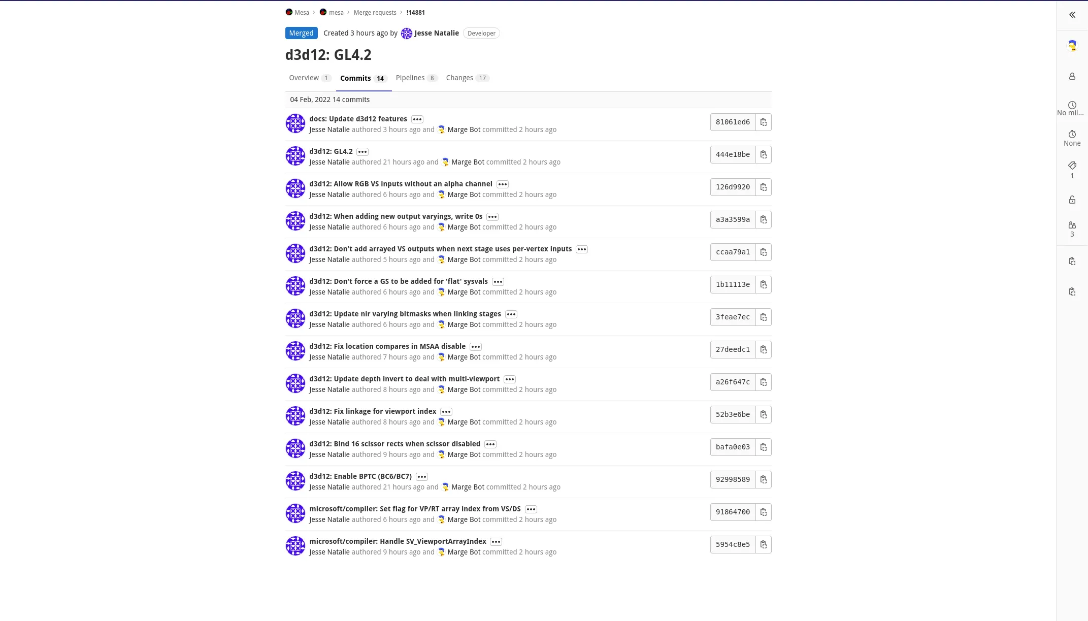

In the survey, listed as a con for WSL 2, is “GPU Hardware acceleration does not work (which affects RViz)”.
However I don’t think this is the case anymore. Work has been done in Mesa to add a DirectX Gallium3D backend, so OpenGL apps should “just work” out of the box with hardware acceleration on Ubuntu 22.04+ WSL 2 guests.
https://docs.mesa3d.org/drivers/d3d12.html
OK, thanks for the info. We have some conflicting reports about this; the Gazebo team seems to have had some trouble with using WSL2. We’ll take a closer look and see what we can find.
Those articles are dated 4 February 2022 and 8 November 2023. I think I tested the WSL2 option sometime in late January and while I don’t recall rviz being problematic, Gazebo definitely was. Especially Ignition with its as of yet unoptimized PBR rendering pipeline that grinds to a complete halt without full gpu acceleration.
Might be worth trying with Ubuntu 24.04 that comes with Mesa 24, a big jump since what was available back in January.
