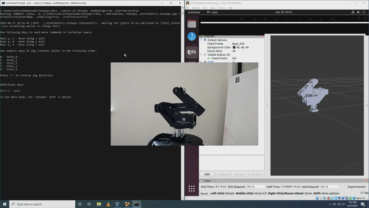

Demonstration
The demonstration consists from two use cases where we control the Dorna2 arm with:
  1. teleops - CLI application which sends commands to MoveIt2 Servo
  2. MoveIt Planning plugin (inside RViz) which sends commands to MoveIt2
In both cases, all MoveIt2 components interact with r2d2_control to control the robot. The entire flow looks like this:
Demonstration videos
Servoing the Dorna robotic arm with teleops
Planning and executing trajectories with MoveIt MotionPlanning plugin
