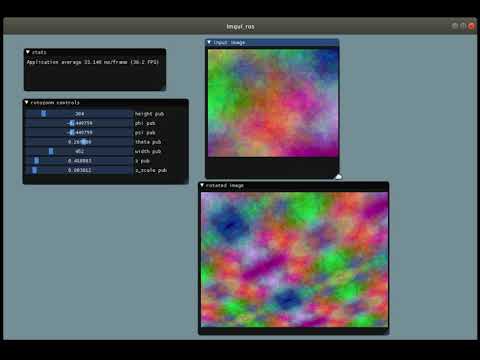

ImGui
https://www.youtube.com/watch?v=UH5tKfWn-KM
https://github.com/lucasw/imgui_ros/tree/bouncy - ROS UI using imgui https://github.com/ocornut/imgui ‘Bloat-free Immediate Mode Graphical User interface for C++ with minimal dependencies’. Currently it can display std_msgs topic values and simple plots, and images, and publish to same std_msgs with slider controls- all of which are created via service calls. The resting cpu usage is higher than a native gui but it ought to scale better for lots of graphics (especially 3D graphics later) and changing values. I’m currently using the SDL2 + OpenGL3 backend but could separate that out so any backend could be integrated.
I’d really like to eventually develop node graph viewing or even editing like in https://github.com/ocornut/imgui/issues/306#issuecomment-439653417 .
For use with v4l2ucp there is a script that reads parameters set for the type, min, & max of each parameter the v4l device supports (probably should make them delivered in response to a service call instead) and then calls the imgui_ros service call to create a slider or dropdown menu to change the parameter via a topic (though ros parameters instead of topics probably are better for this).

iir_image - subscribe to a number of image topics and combine them with parameter coefficients (e.g. 0.5 * image_0 + 0.5 * image_1). Or instead of multiple topics keep a buffer of received image on one topic and use the coefficients to combine the current image with images from the past.
roto_zoom - rotate and scale an image.
