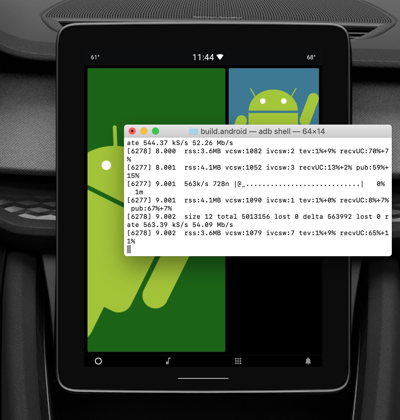

@atyshka @tomoyafujita Eclipse Cyclone DDS Tier 1 ROS middleware project of Eclipse IoT and OpenADx (autonomous driving) WGs was recently ported to Android and Android Auto for some automakers. Does it help you with ROS2 on mobile devices?
here is Eclipse Cyclone DDS running on Volvo’s Polestar 2 head unit in emulation
