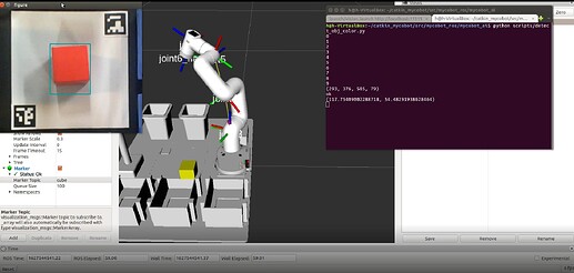

Artificial Intelligence Kit:
Guide the robot through robot vision and realize intelligent grabbing simultaneously. The intellectual grabbing of wood blocks and the intelligent grabbing of image objects have been developed.

1: After the myCobot280 normally runs for a period of time, the machine heats up, and the RVIZ cannot run normally.
2: On the Raspberry Pi version, after turning on the RVIZ, it was found that the computer’s CPU was instantly occupied and could not run stably.

This sounds more like a topic for answers.ros.org
Please check that you are using gpu acceleration and not just software rendering. This can be seen in the output of rviz at startup for example
Thanks for the suggestion, I’ll try it out. :grin:
