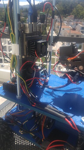

Yes, that right but is somewhat expensive 300 with the dc motors with encoders.
This base had some problems and the motors were mediocre but did the job, also a little hard to get accurate TF.
On Hindesight i would recommend a 2 leveled wooden base spaced out with rods.
On the bottom level lidar (elevated above the electronics) - battery- arduino etc…
(below the bottom level dc brackets - dc motors with encoders - FIT0493 this might be a better option from the lynxmotion motors that their encoders don’t mount well…)
Above level - the jetson nano - arm - dc-dc converters
And finally a top top elevated platform for kinect. (explanation here a little rush)
This should come cheap ~ 30-50 and for the motors 120-200

Hello,
I build a new cheap easily reproducable base which it seems much more calibrated and navigation is good
with only 8mm thick wood pieces (2pcs x (20x31.8)) and (1 pcs x (10x20) for kinect base)
8mm metal rods and nuts.
equipment: black decker w/ 8mm wood cutter tip. (for the rods to pass through and cables)
(for cables open up bigger holes), glue for securing the nuts, measure 10cm for upper platform, 40 for kinect platform, and finally strong double sided tape
for lidar i cut 6 pieces 5x7 to reach a height of 4.8cm and then i double taped the ydlidar…
i will push more detailed instructions on the git sometime
