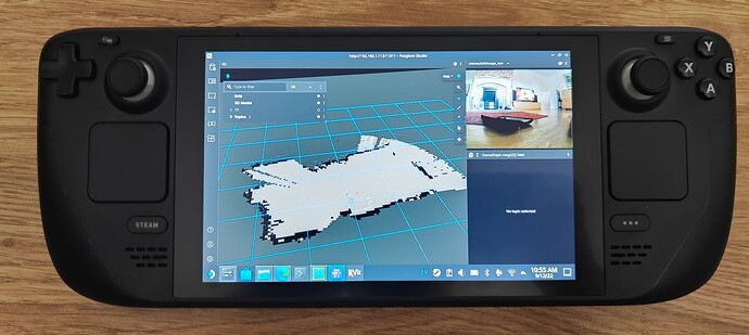

It works a treat! I have up on the package manager as I’m new to Arch Linux but installing Noetic using RoboShack and its worked a treat!
I got my Turtlebot 3 up and running, got teleop working using the built in controllers, and fired up the SLAM package on the Deck and it’s worked an absolute treat!
I’m running a StereoPi board on the Turtlebot, tomorrow I’m going to try and get the stereo cameras working and see if I can generate a 3d map on here.

It needs a lot of tuning but with a Stereo Pi on my Turtlebot3 I’m generating a point cloud and rendering it on the Deck!
I had a request to test Foxglove Studio on twitter, the native app installed fine.
I think an actual ROS application in the Steam store would be the best solution, but with the desktop readily available it’s remarkably capable.
