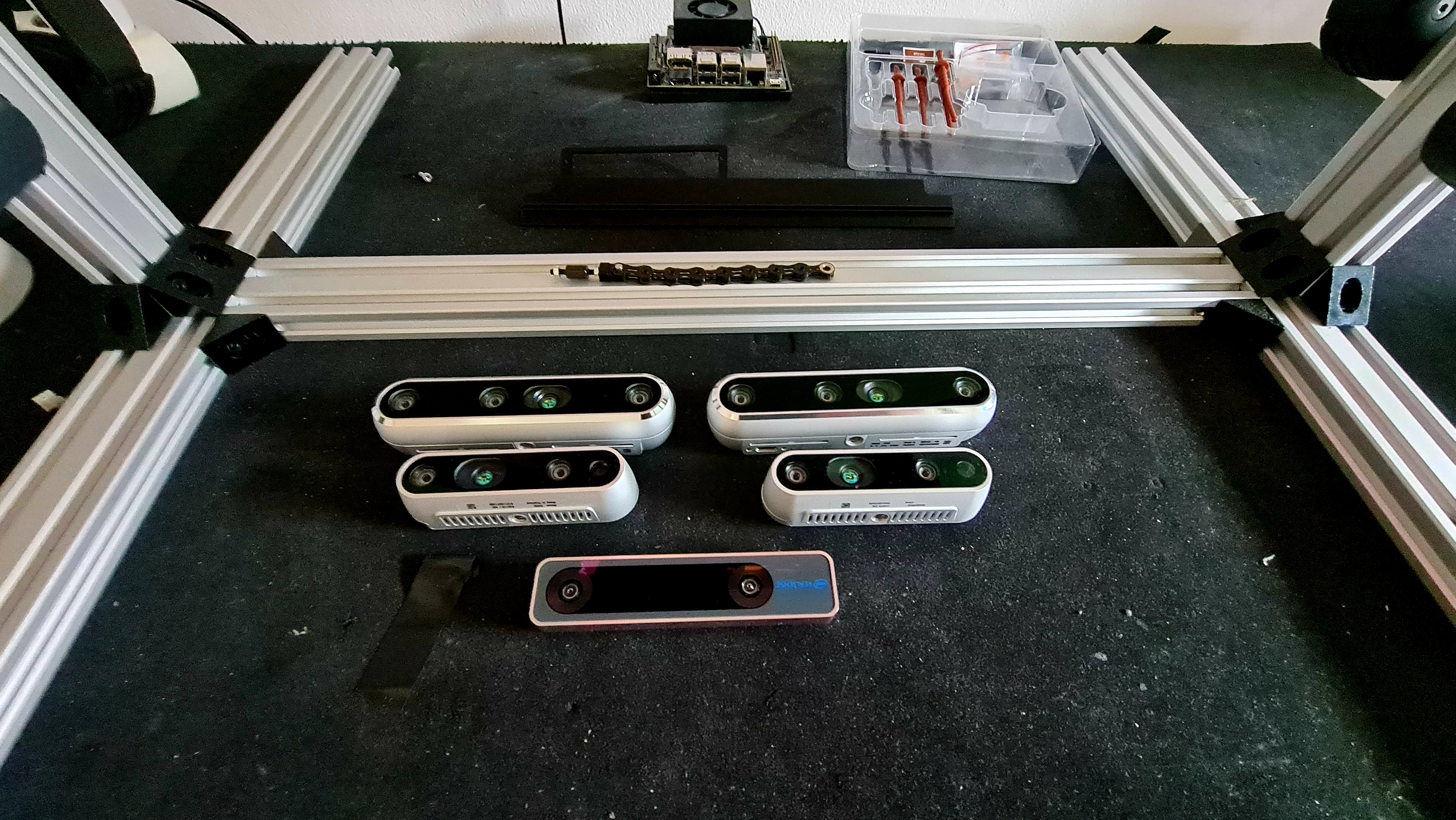

New toys
Front cameras and right side camera testing outside! as one can see the right side camera overlap with front cameras at around 2m from the robot. Giving the robot a very small blindspot.
Video: K3lso vision testing outside - YouTube
#k3lso #quad #quadruped #robotics #UPXtreme #ROS #Ubuntu #MIT #realsense #intel #d435 #d455
