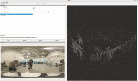

Omnivision is an open-source sensor fusion package designed to integrate and process data from 360° cameras and LiDAR sensors. This tool is developed to support advanced perception tasks in robotics, autonomous systems, and other applications requiring multi-modal sensor data fusion.
I had the idea for a competition robot and created the package at a hackathon. I’ve since refined it and you can find it here: Blainektmo/omnivision.
Would love to see where others can take this with performance improvements/useability!
Features
  • 360° Camera and LiDAR Integration: Full environmental coverage from 3D LiDAR and 360° camera.
  • Data Fusion: Combine camera and LiDAR data to generate textured point clouds.
  • Depth Map Generation: Creates textured and grayscale depth maps.
  • Dynamic Visualization Compute: Only generates pointclouds / depthmaps when topics have subscribers.
